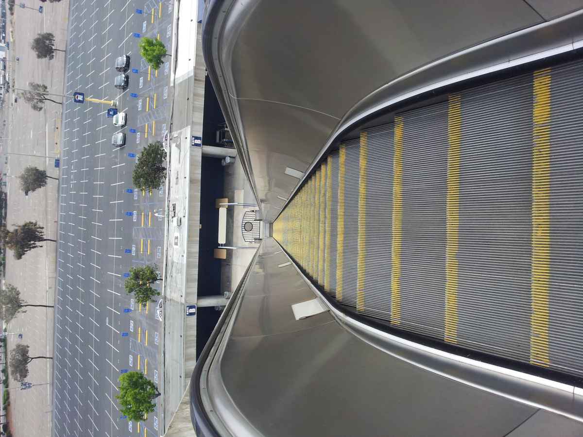

Awesome!
I would like to have seen how they got the truss installed.

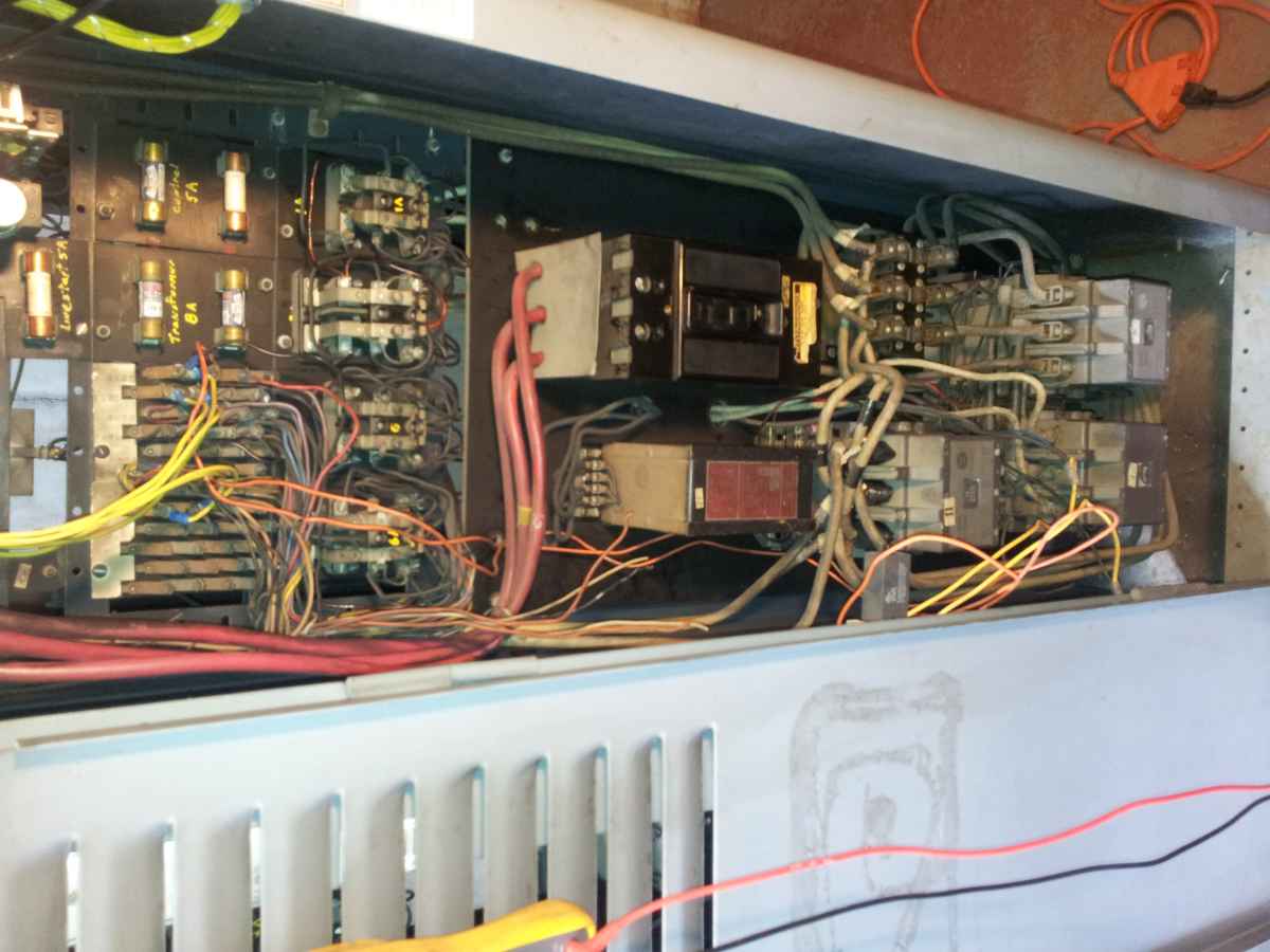

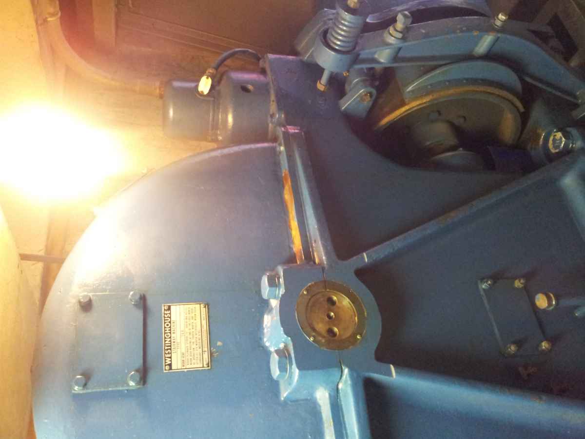

These units are at Qualcom stadium in s.d. My buddy's Co. picked contract up recently. Helped him t/s found mechanical walking beam hanging up between up and down contactors. 50hp drive motors on Westinghouse machine.
