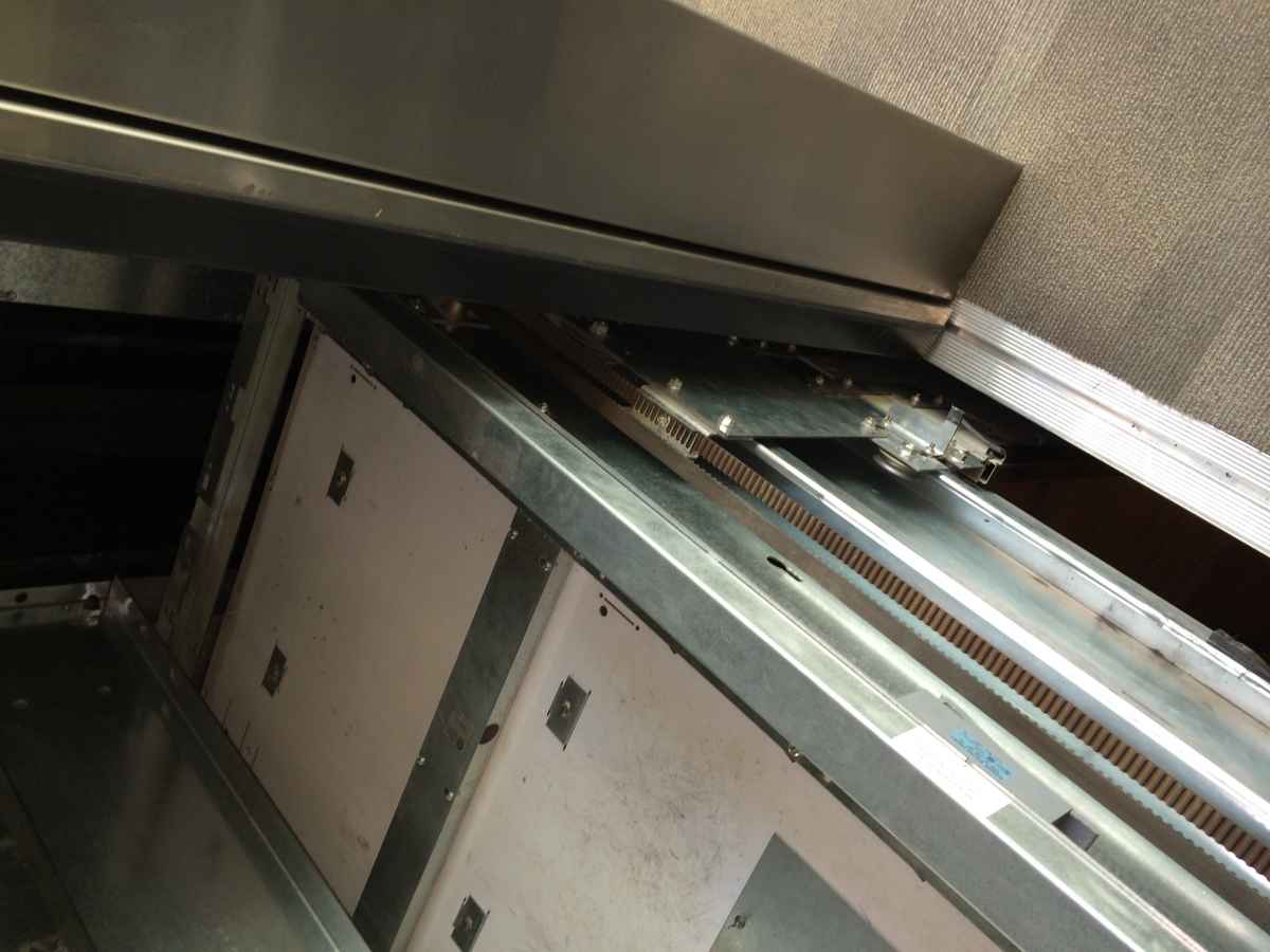

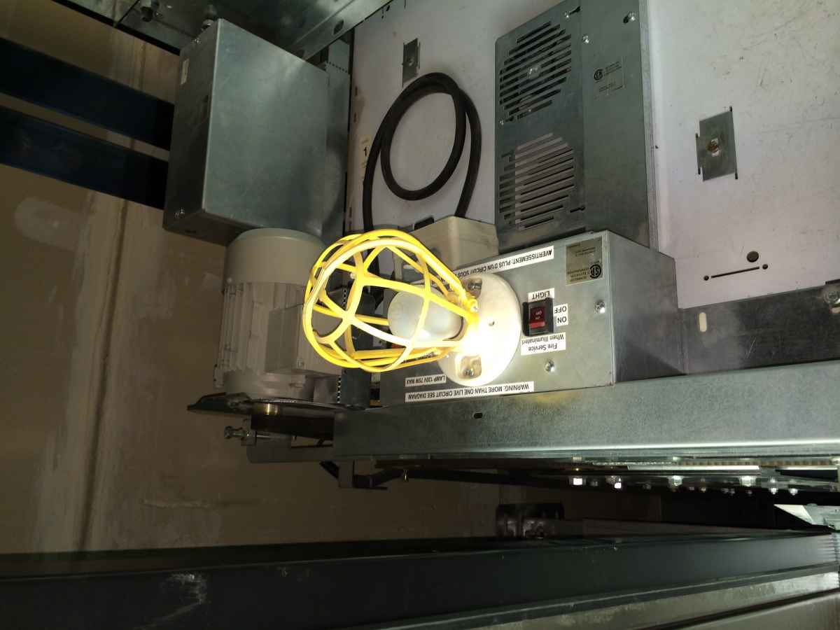

Just picked up this Schindler car and the door opens and closes very slowly. We suspect it probably has a bad encoder. Is there anyway to adjust or re-learn without the tool? Any other ideas why it would be running so slow? Thanks for any help!!

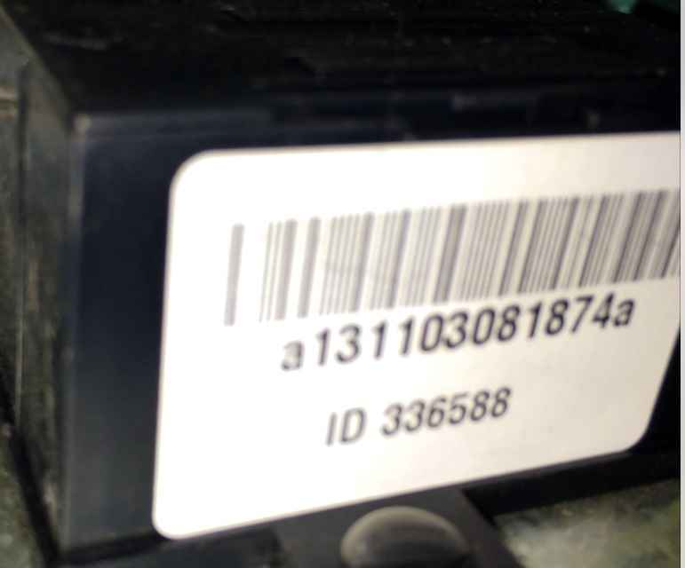

Looks like a QKS-16(VF). What unit is it on? 321a, 330a, 400a
Is there a chance the previous service mechanic changed the potentiometers?
This one is on a 330A. Where are the potentiometers? Are they in the box that looks like a power supply?
Sorry Admin,
I'm going off of memory here. The board was usually in the car station. Do you have a print and/or a manual? I'll try and stop at one of our customers on my way home.
