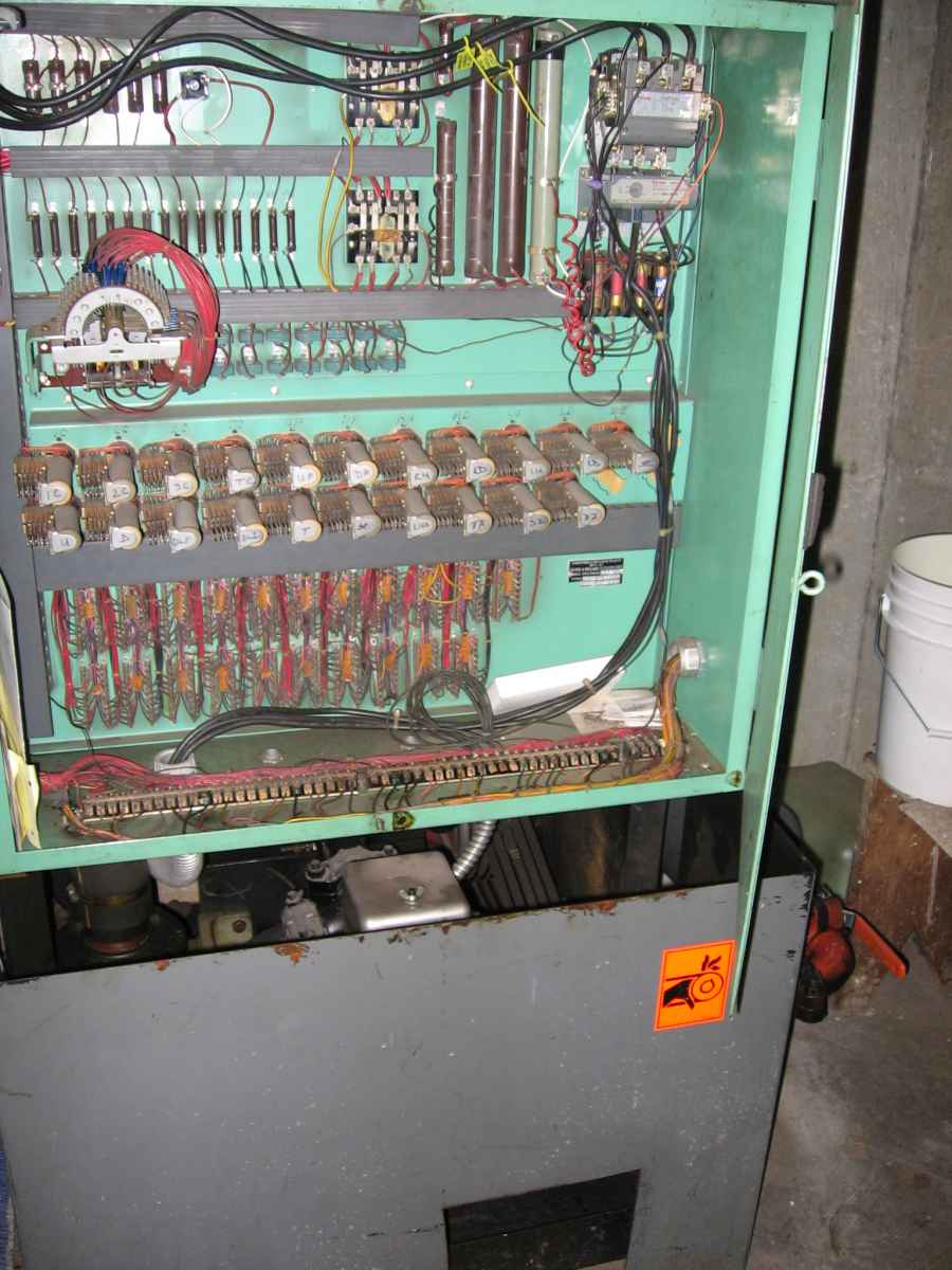

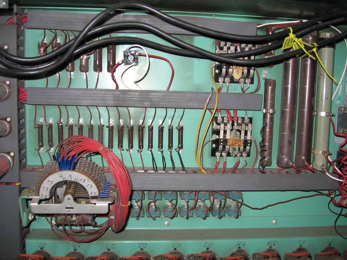

You can just replace the selenium rectifier with a postage stamp rectifier as shown in the controller image. You should read about 200 to 210 VDC if the rectifier is good.
