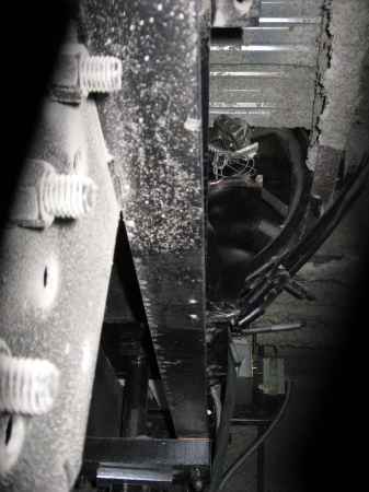

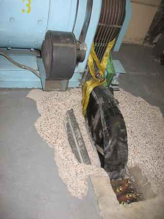

Here are some images of an elevator's cartop sheave that went through the machine room floor. Were not really sure how this happened or what the circumstances were that could have caused so much damage. Notice how the shackles are pulled into the cartop sheave. This must have been a hell of a ride!

All I can say is WOW! Are there more cars like this one? Is this building so tall that the machine would continue to provide traction from the weight of the cables only????
Apparently, this happened during an emergency power test. This was the only car to go through the overhead. Another car went into the overhead but did not push through. Our best guess is that some how the phasing was reversed and the elevator took off out of control in the wrong direction.

There is no way the machine crushed the cwt frame and buffer and had enough inertia to send the car that high at normal speed. That is a reduced stroke buffer so is prob <500 ft/min car. I'm guessing the brake picked and the low line circuit was jumped out causing it to free fall because the EP generator couldn't output enough current. what controls drive that 155ht machine? Guess that's why we do our emergency tests to find crazy stuff like this.

Amazing, What was the runby like...Over the years have seen many units with limited head room. That's the first time I've seen that!
The runby appeared to be good. This is a 700 FPM Otis 401 controller with MGs. GreenPants, that is a good Hypothesis. It is very likely that's what happened. Good Job!
check to see if all the MG's started at the same time causing a EP gen overload.also the phases for the EP gen is a good call. normally 401 WL drives will have one car selected on the EP car selection to prevent all the MG's from starting at the same time.

GreenPants, on the 401, what if the power phases changed/reversed? is the controller looking for feedback in one direction but was going in the other? Phase monitor in place?
I would like to see what happens on an emergency power test here. This is not a building that we service. We were just called to give a competitive bid on the repair. I did see the video from the camera inside the elevator. It closed its doors on the Lobby (1st Landing) then proceeded to go straight to the 22nd floor (Top Floor) according to the P.I.. It had plenty of time to trip the governor and open the safety circuit if the car was overspeeding. This is just a weird deal!
Ya this seems wierd that it didn't stop electrically a 401 has a few redundant systems that should have dropped ees or c. I would check the brake a 155ht brake arm needs adjusting sometimes do to worn bearings on the armature and or worn bottom bushings on the arm. It causes only part of the brake pad to apply friction. I doubt that it broke traction being a 180deg wrap with liners.
