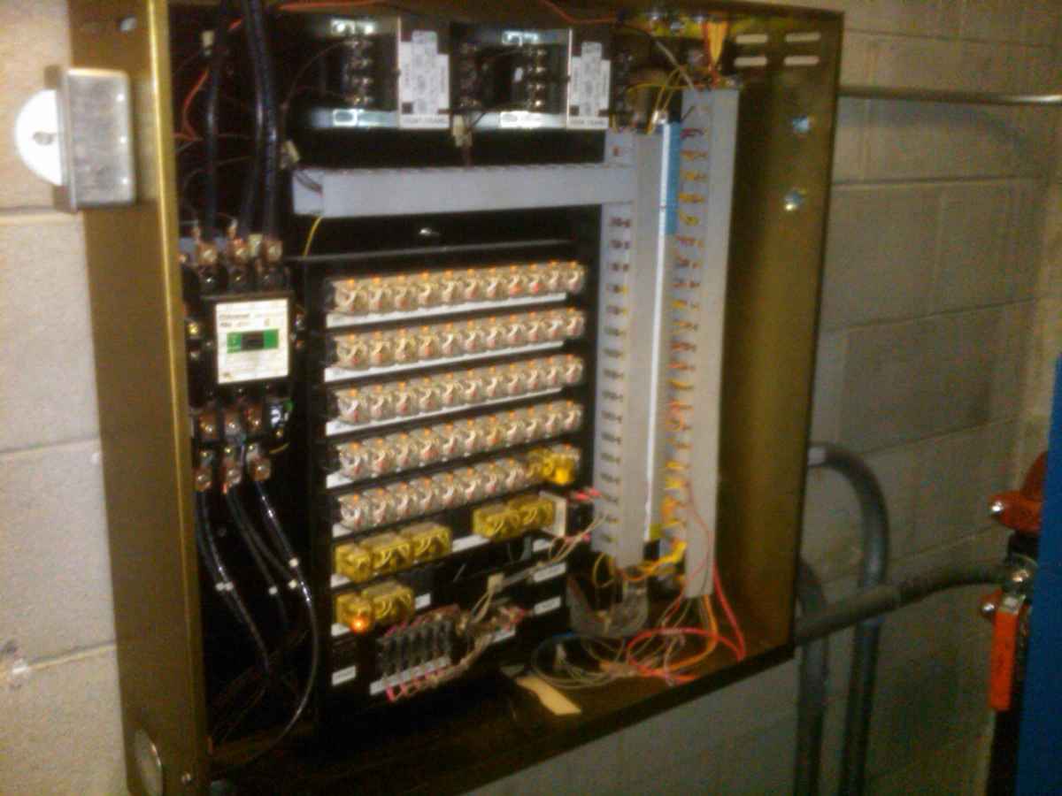

Does anyone know which controller manufacture this is? I couldn't find any data plates, part #'s, names, nothing!!!!!!!!! All the relays are 48 VDC. Any help would be appreciated. Thanks.

Check with ERM. http://www.elevatorresearch.com/
I think they recently sold out to Circus Elevator or Clowney or something that sounds like that.

that kinda looks like a century controller

Not ERM. I have installed/worked on everything they have made. The OW stuff too.

Maybe it's a Delta.

It's very similar to a Delta controller. I thought maybe they built it for someone, but they said no. Plus, I think they used 110 VDC relays rather than 48 VDC relays. This is a tough one.
Is it possibly an "Elevator Systems" controler? It looks very similar

looks like possibly an older virginia

You might be right on the Virginia. I'll have to check with them. I've never seen an all relay Virginia Controller, but that doesn't mean anything. Thanks for the tip!!!!!

i've seen a few virginia pure relay logic controllers

Maybe it is a "Precise" . I have an old precise print which has terminal designations very similiar to a Delta. it also has 48vdc relays.
Hey Scott, it is a Precise Controller I got the print and it matched perfectly. Thanks again! Good Job!
