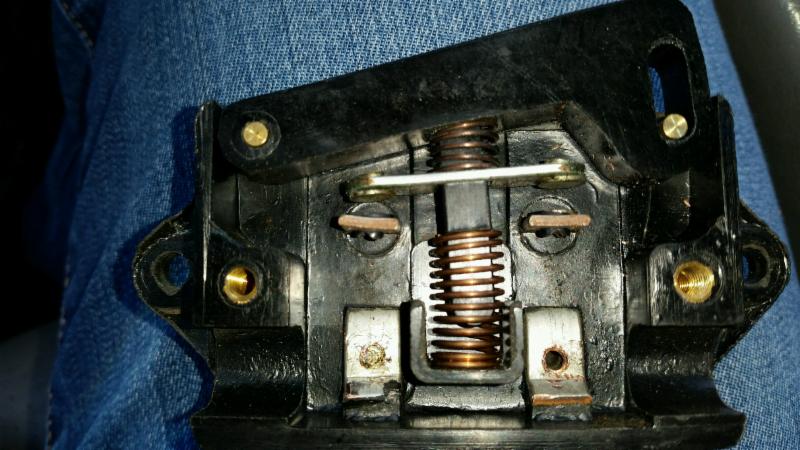

So, I'm a newby and discovered this forum via googling, and my hope is someone has experience with this type of "antique" elevator.
The elevator has served the family well for many, many years, and really looks good, especially the mechanicals etc. I believe it was installed around 1962 when the house was built.
The elevator will run to it stop or top floor (two) and would not go down. Then after a few days it would decide to work again.
I had an elevator repairman come over and he cleaned the contractors, etc, but that did not fix it. Then he sort of jumped up and down up in the elevator and it worked!!
I just had and electrical over and he did the following-some of it duplicative from the previous visit.
1-checked all door switches, contacts are clean, and all have power
2-Checked the chain limit switch (counter balance) it appears to be good
3-Travel switch in the back of the back corner of the roof left side
4-Checked all three call buttons two external one internal
5-Checked all terminal blocks for tightness
6-Checked tightness on all on contactors
Still it will come up, not go down, unless you move about and shake it in the shaft. So, it would appear to me that it is a switch or something that is not being engaged or making a connection, or something is loose.
Anyone have expereince with this? Your suggestions will be appreciated!

So the latest is the tech took the elevator down from the top about half way, stopped, back up, half way, stopped, back down half way, stopped, all the way up, then all the way down, then back up all the way, and it would not work again until he shifted around again in the elevator.

May be be a broken wire in the travel cable. A licensed elevator tech should have little trouble narrowing it down if he can catch it while it's not working, assuming there is an accurate set of prints.

Should be a stop switch in car to check also,double check the limit at the top,not much to those up and Down contators I'd say the lock at the top floor if u have to jump on it to run.

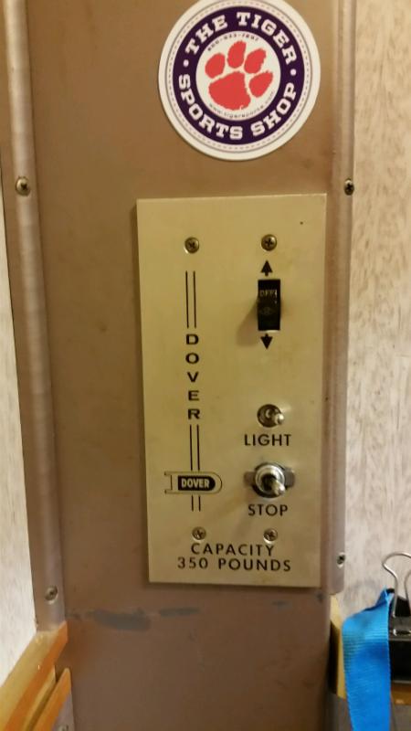

As a layman, that's what I was thinking. The first tech did not kill the power and I heard the result of the contact with his screw driver from the upper floor. Then he proceeded to pull the 50 year old stop cord from the ceiling, as it was not hooked up to anything but the bar.
Then today it was found out that a contact screw was broken off by a tech in the limit switch on the roof that has something to do with the chain. I had to round up a friend with some machines that came from the Charleston Navel yard just to get that pulled out and re threaded. Seems so far I have encountered incompetents. Not to mention the first speeding ticket in about three years as I rushed over to his home as he was in a hurry.

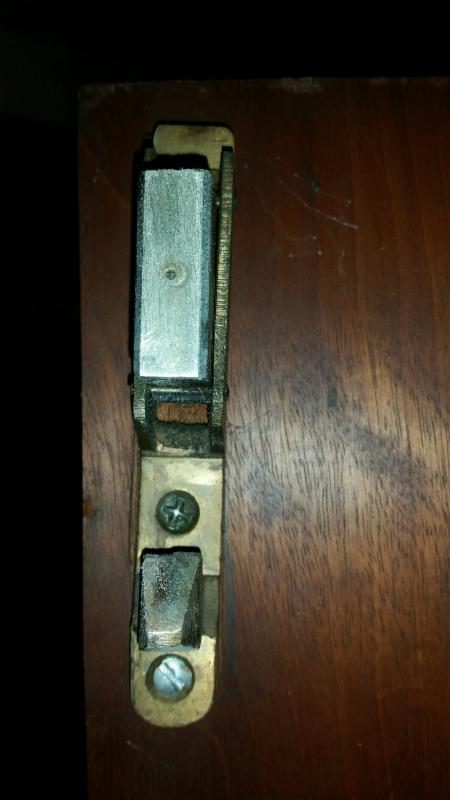

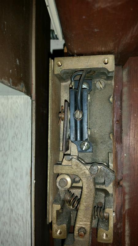

That door lock in the picture, the contacts are pitted pretty badly it may not be making contact. The male piece in the picture doesn't show any signs of wipe. From the discription you have givin it sounds like either the door lock or the top final limit.
There is a guy in Columbia think the name of his company is Carolina elevator.
