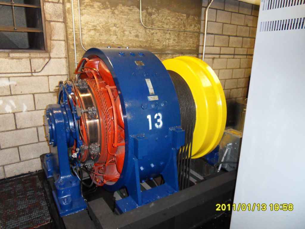

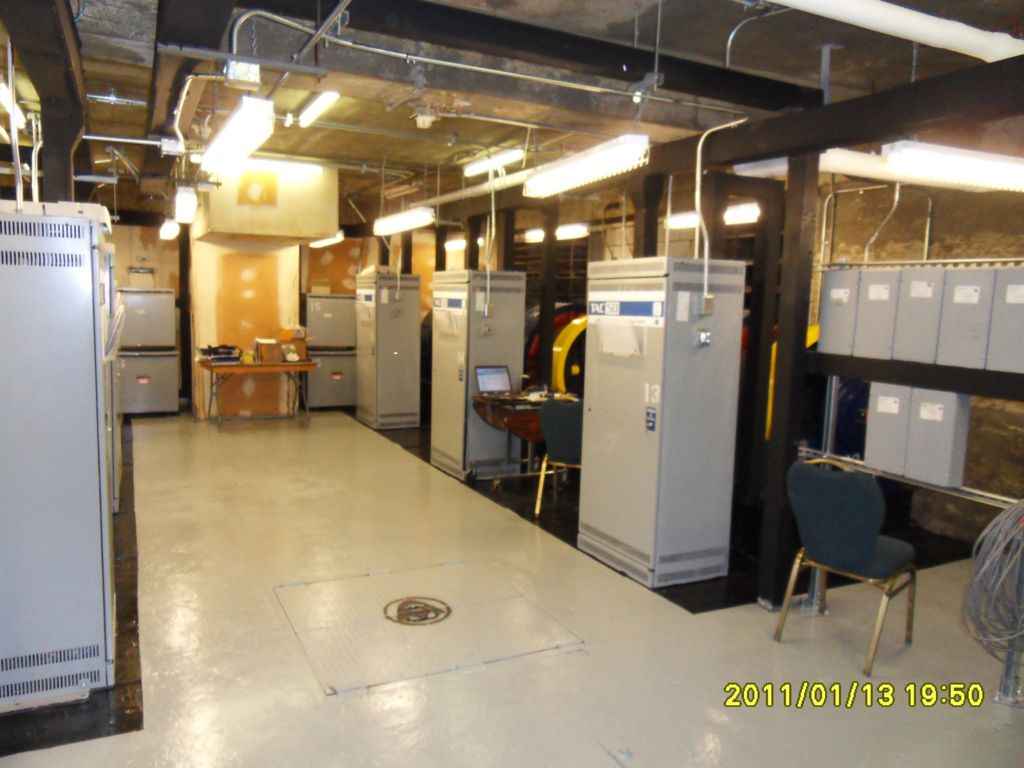

nice work, looks great.
Nice job! 1000 fpm?
Is that the same basic selector case from the Dover days? How long do you get out out of a set of selector guides? Looks like the same tape, at least.

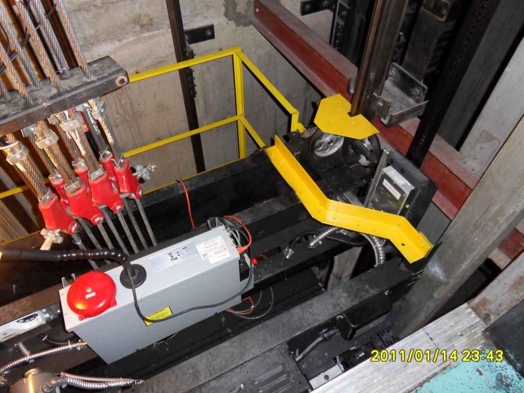

Vic: No Only 800FT/Min. Around 500 foot rise tho..
The tape head guides last a while.. 8 months to a year PROVIDED the tape head is setup perfectly.. The Selector tape is similar to a Tac20 one.. We do position/door zone/normal limit and ETSD/NTSD all off this unit..
Matt: we were humming along at around 8-10 weeks a car start to finish.... this was a MAJOR mod.. Those 626SE rope grippers were a pain in the ass to work with ( around 400lbs ) Lanterns and gongs at each floor sucked too...Fiber Optic comunication to main desk etc.... I love it when I hear you can do a mod in 4 weeks.. NOT this one =)
Nice job, that's a REAL mod.
