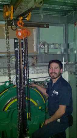

At first glance, it looks like the hoist ropes are held captive by the motor. During construction, they thread the hoist ropes through the machine, (no motor dissasembly required!). But to remove the motor after it has bneen roped up, the hoist ropes are now "holding" the motor behind the rail. You either have to take the ropes back out of the machine, or you have to partially dissasemble the motor. The latter is the easiest route.
You take them out of the motor by removing the iron cross, that holds them captive. After disconnecting the 3 phase, tach, resolver, cooling fan, emer brake release cable, etc, you rig the top of the motor to steady it, then unbolt the top motor stabilizer from the rail. We loosened in advance the iron cross center bolt, that went from the rear of the stator, where teh head of the bolt is, then it goes out to the iron cross, where it tightens into a threaded hole in the cross. Then by loosening the rigging, we leaned the motor over towards the wall, so the cross has room to wiggle off of the stator housing.
Then we could rock the iron cross out away from the machine, just enough to get the ropes free. Only our cross was painted stuck to the stator housing, so we had to tap it and pry it back and forth to get it loose. It also has locating dowels down at the bottom, so the cross has to move straight back to slide off the dowels. We actually took it off the end of the sheave shaft. The cross has a round machined mesa, about the size of a hockey puck, that tucks into the sheave shaft or bearing inner race, and this helps support the sheave shaft.
As the iron cross is rocked horizontally from side to side, it reveals enough space between it and the stator housing, to where each rope may be pulled out from behind the cross, and tied up out of the way. This divorces the hoist ropes from the machine, and allows the machine to be removed from the shaft. The iron cross was easy to get back on. I've got the motor up off the pedestal, ready to go out the entrance. Next I need a cart that can hold 1,760 pounds!

Here is the motor in question. You can see how the hoist ropes go through the motor. And there is my esteemed associate, Santos.
