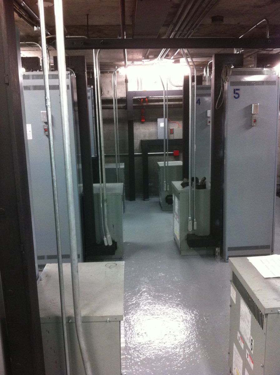

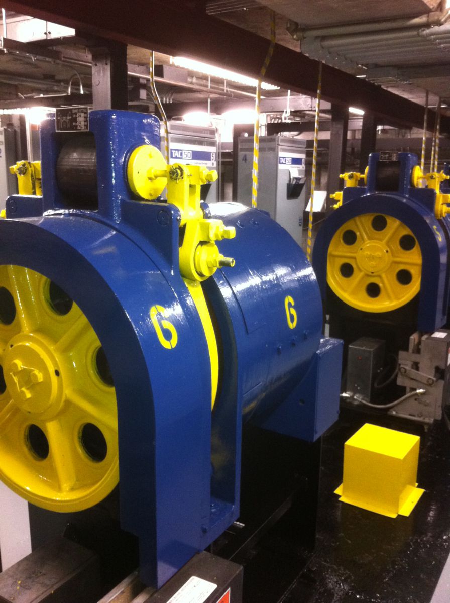

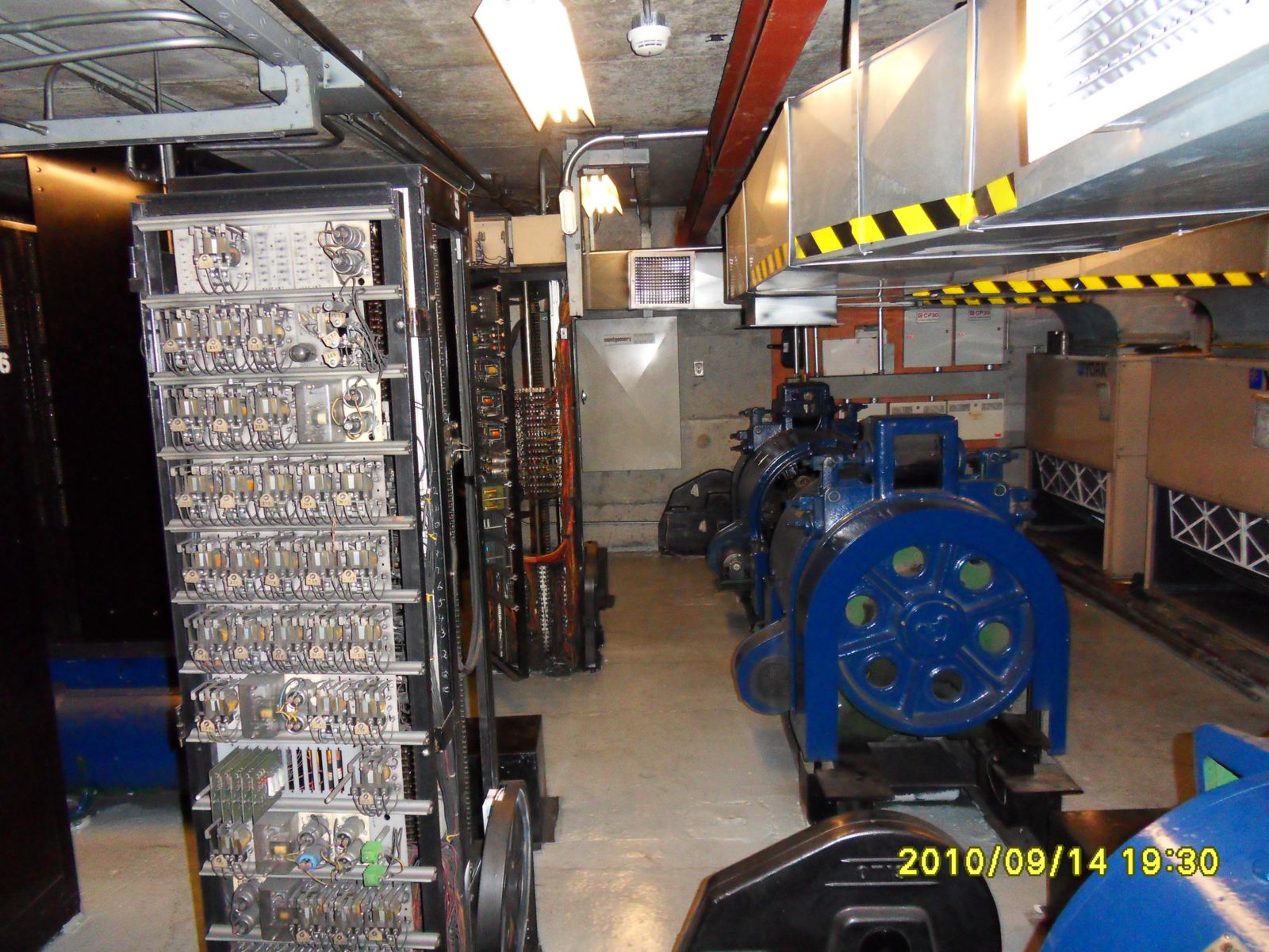

Hi Gang,

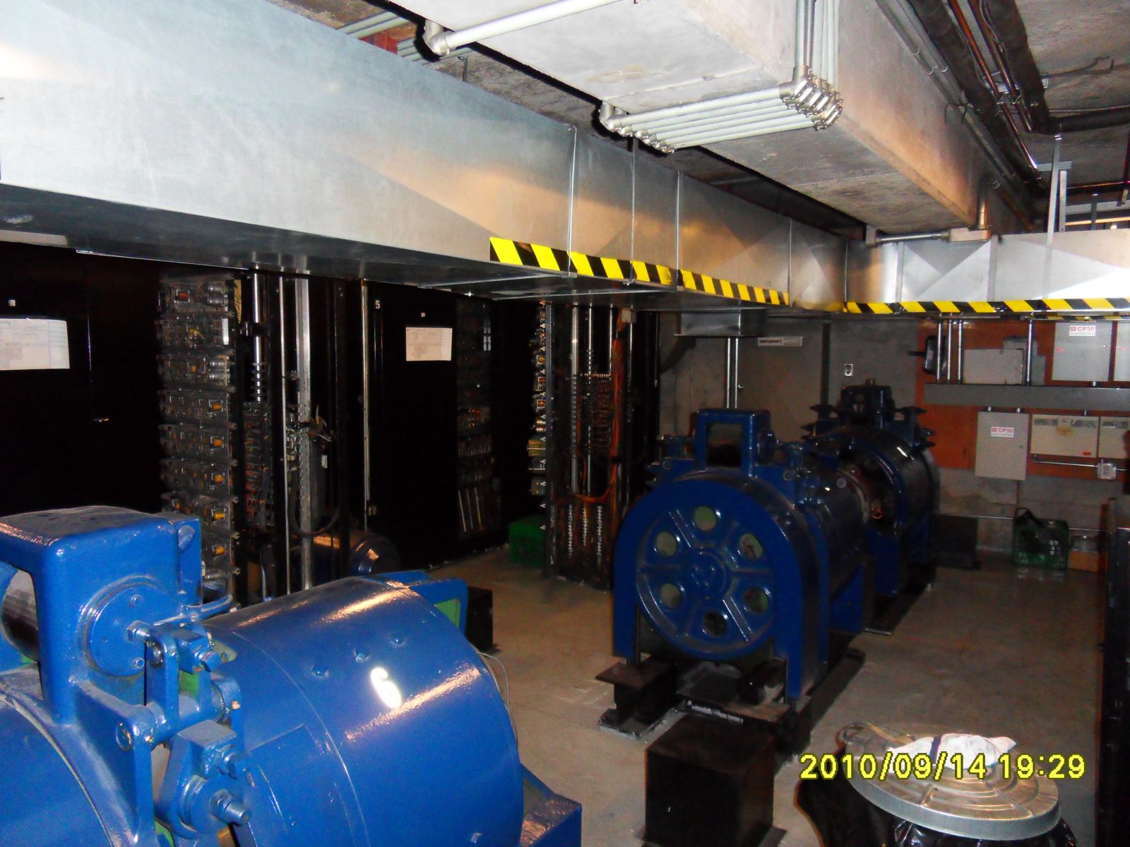

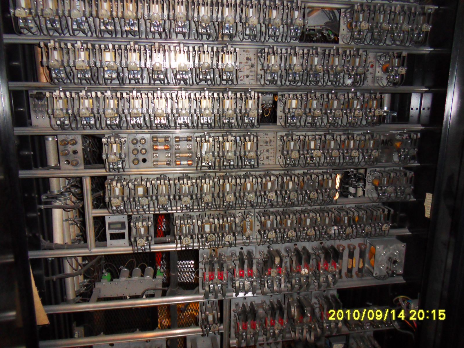

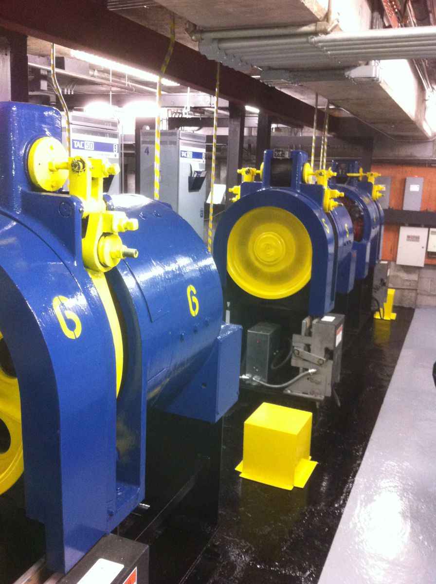

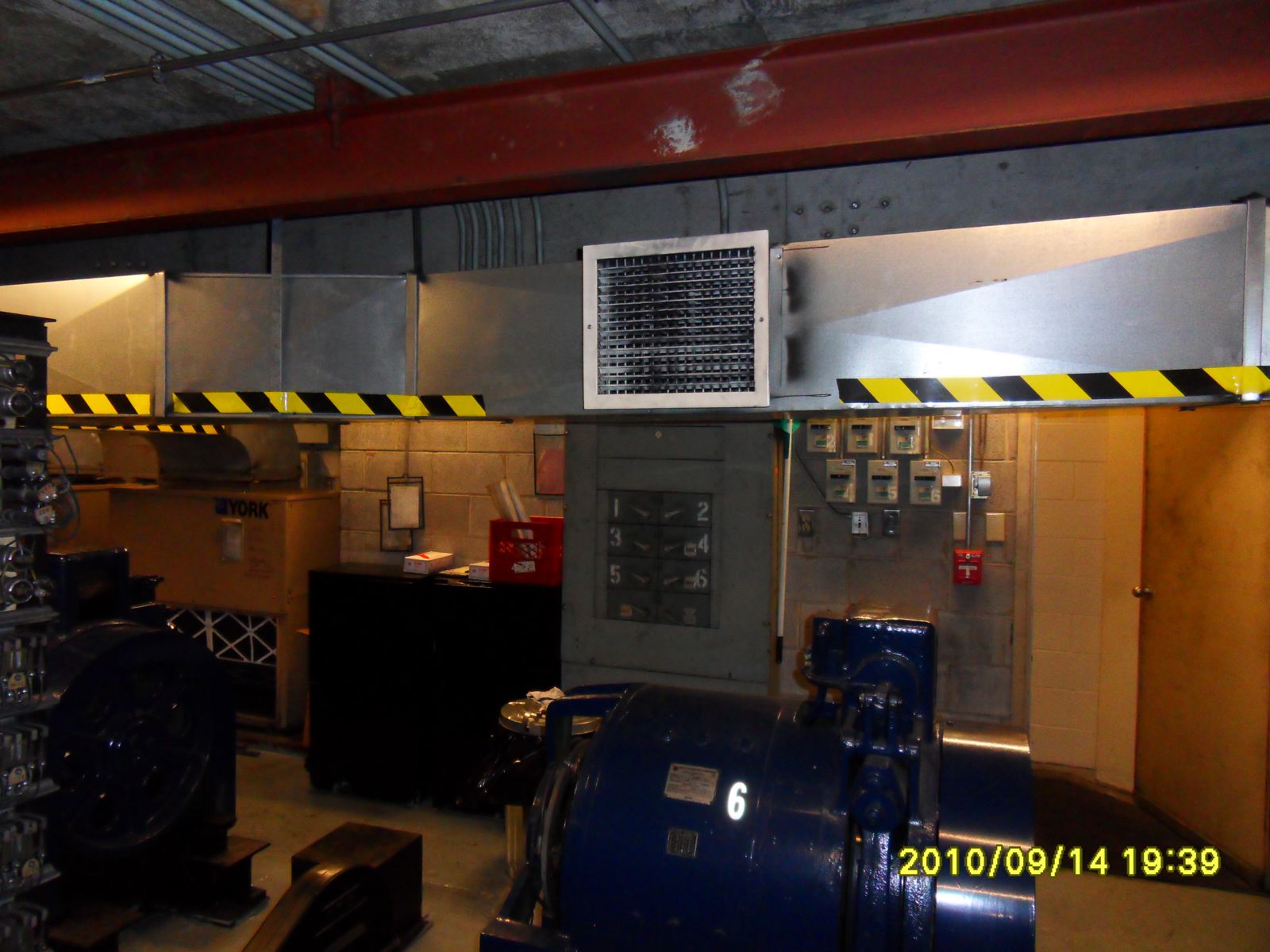

Just thought I would pass on some pictures of a mod I just wrapped up.
Old Equipment:
Otis 131HT Machines
Otis VIP 260 with a good ole MG set
Otis 6970 door operator

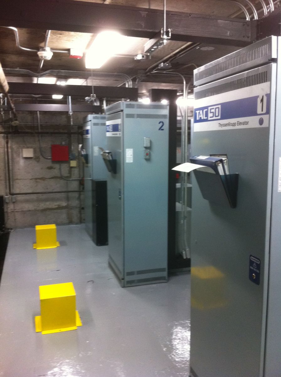

New:
Otis 131HT machines ( refurbished )
TKE Tac 50-04 with PWM 10K drive Gov/Motor encoders
Hollister Whitney 624 rope gripper
Dover HDLM door operator
Enjoy
Dave
[img]http://nevinfamily.ca/atrium/After%20Mod_Mach1.JPG[/img]
[img]http://nevinfamily.ca/atrium/After%20Mod_Mach2.JPG[/img]
[img]http://nevinfamily.ca/atrium/After%20Mod_Mach3.JPG[/img]
[img]http://nevinfamily.ca/atrium/After%20Mod_Mach4.JPG[/img]
[img]http://nevinfamily.ca/atrium/After%20Mod_Mach5.JPG[/img]
[img]http://nevinfamily.ca/atrium/BeforeMod1.JPG[/img]
[img]http://nevinfamily.ca/atrium/BeforeMod2.JPG[/img]
[img]http://nevinfamily.ca/atrium/BeforeMod3.JPG[/img]
[img]http://nevinfamily.ca/atrium/BeforeMod4.JPG[/img]

Very clean job, looks great!

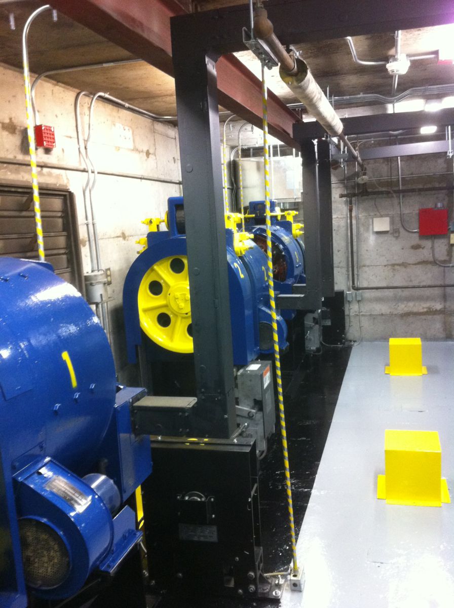

You guys put taller machine blocking under the 131HTs, to make room for the rope grippers?
They look a bit higher, compared to the "before" pics.
why the rope grippers? is it a reg or just a spec requested via the tender?
Certainly a job to be proud of! The yellow/blue hoists really stand out against the black floor.
nice job. you def know it wasnt a otis mod because you can still get to the machine. we have to cover ours with guards so kids can play in the machine room i guess.
Did I see a tear coming out of the 139's frame..
Dressed in Blue and not green..LOL..

Very nice looking job! We are doing a similar job right now but using the MCE I control. I hope to post some pictures myself when it is done. We had to do the same deal to make the rope grippers work.
In Canada we have to have rope grippers when we complete a major alteration (MOD ) or have parallel main brakes that can stop 125% rated load independent of each other.
In the past we used to mount the rope grippers upside down at the top of the hoistway. The government inspector had us remove it and install it up in the machine room. He called it because it was not "serviceable"
This was a right pain in the ass to raise these machines.
The next MOD I am supposed to run we will have to raise Otis 219HT machines up to accommodate a rope gripper .
YUK!
YUK!

thats very nice lepricon, the old otis controllers looked great, now that was service you could see. Kind of sad to see such a great looking otis controller go down. the mod does look awesome though great job

Very pretty smile In the before pics that job looked pretty good. Its always nice to see the 260's get ripped out. Now hopefully the service guy will keep it that clean frown
