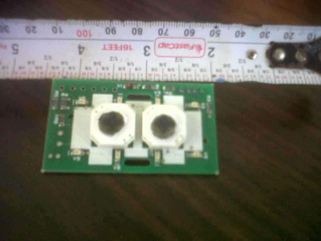

Hello Anybody know where I could find this type of push button ?

What type of elevator did you pull this from? It almost looks like something Innovation was putting out for a while. Is this for a Bar Button or standard button? Try sending this pic to the folks at Innovation. Good Luck!!!!!

It was install in a old Kone / Montgomery elevator but not sure this was the original button ?

It's a 220 series button kone/ montgomery there junk foam wears out button no longer works you can take the foam off and glue two little washers in place of foam there available from Kone spares

I tried to edit new ones are available from kone spares or Adams .Its such a waste to use the foam when the buttons really never go bad foam just wears out.

You are exactly correct the push button still good just the foam wear out .
I did the same thing I glue a pieces of plastic on top of the push button .
But I still need to order some , I have some that not working after receiving rain .
Thanks I will look again in Kone Spare .

i guess im cheap i usually fold up a piece of paper out of my pocket pad and install it in the button been good for about 3 years now.

Adams told me they wanted $750 for this button board!
Kone spares wants $75, still expensive!
Worth about a nickle.
