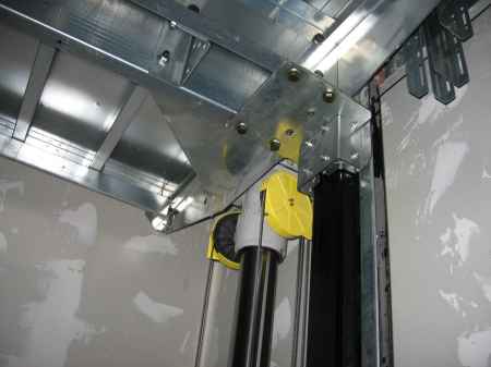

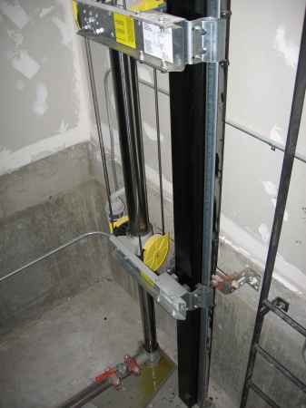

Schindler 330A Repack?
How the $%#@ do you repack this thing? Is there an easy way to repack this upside-down holeless cylinder?

When I was working for the big S, I was told you could do both sides start to finish in 4 hours... I believe D.L. Martin fabricated the jacks....they may have info. Use air to return oil from piston to tank...this will help keep oil mess in pit to a minimum.

I've also been told to allow atleast 8 hours...The last reply was info from a repair crew who had done afew...No real easy way...

I have repacked these hole less hydros its 8hrs repair one side if you dont have repair instructions could be a long day

Actually not that bad. Definetly take your time. About 6 hours per side would be the norm. Mine had accumulated rust in all of the snap ring grooves. DO NOT just buy the Texacone seals. They have a complete kit that includes wipers (which turned to out be one of the hardest parts), and the most critical pieces, the "O" rings that seal the pistons to the housings. Large snap ring pliers are a must (0.095). Blowing air into the top of the cylinder from a compressor was a huge help with mess reduction. Although for some reason the bleeder plug is a metric bolt thread, not pipe thread. So use a rubber tip from an air gun.
