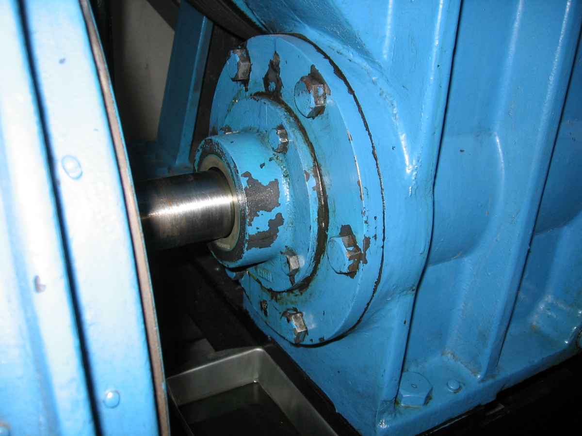

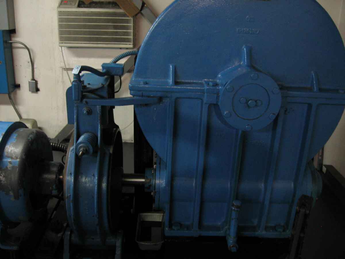

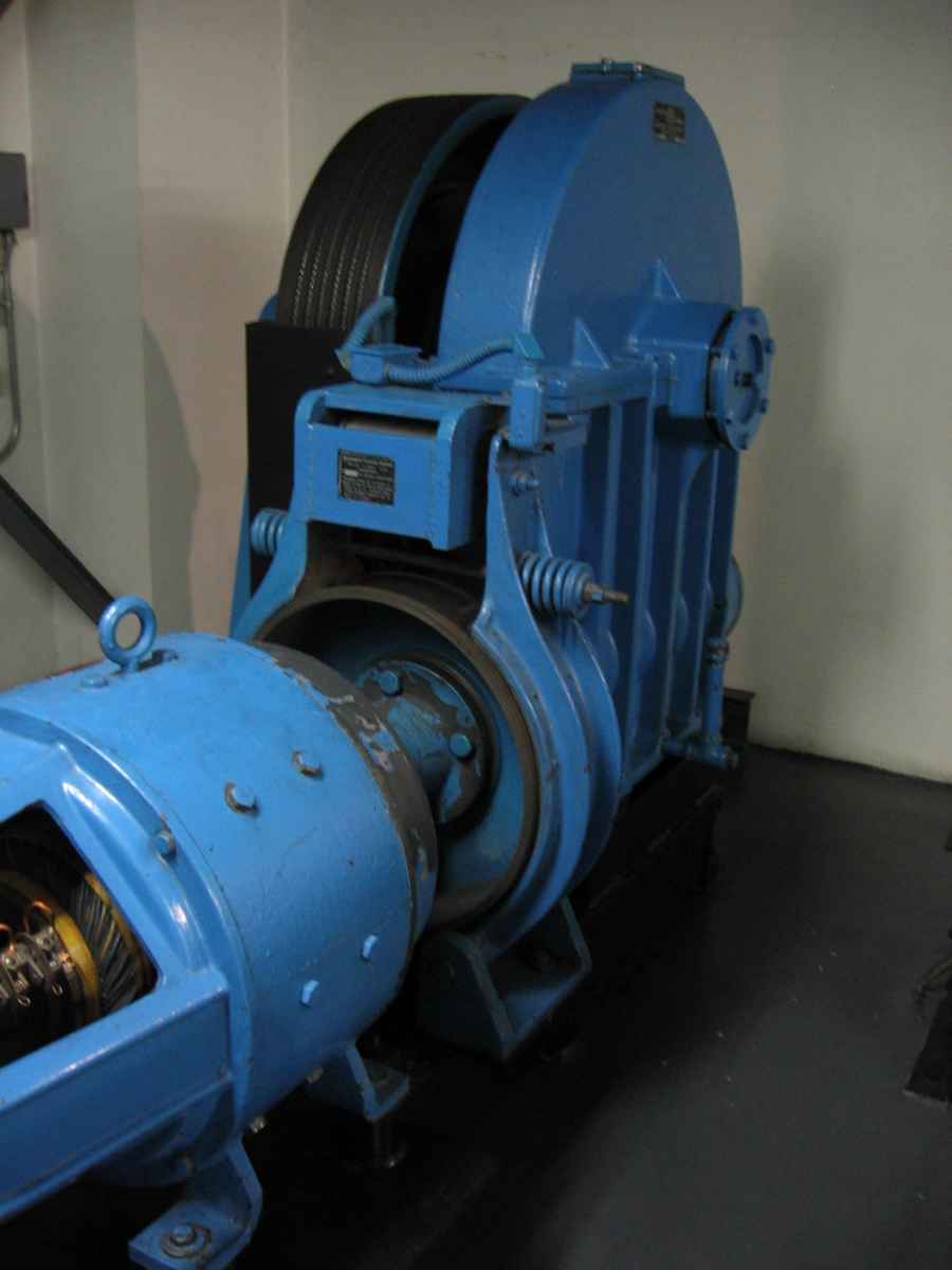

I've been told by Kone that there is no split worm seal for this machine and the only way to seal it is with a solid seal. Has any one ever had to seal this machine before? Do you really have to remove the motor to change the worm seal?
Posts: 4
Posts: 4
Afraid you will have to pull the hub, I've always done these without a split seal, I'm pretty sure kone doesn't make a split one
Posts: 4
Posts: 4
Texacone shows a split seal for this machine but i don't know if it's for the worm. You can call them. I've had great responce from them over the years.
