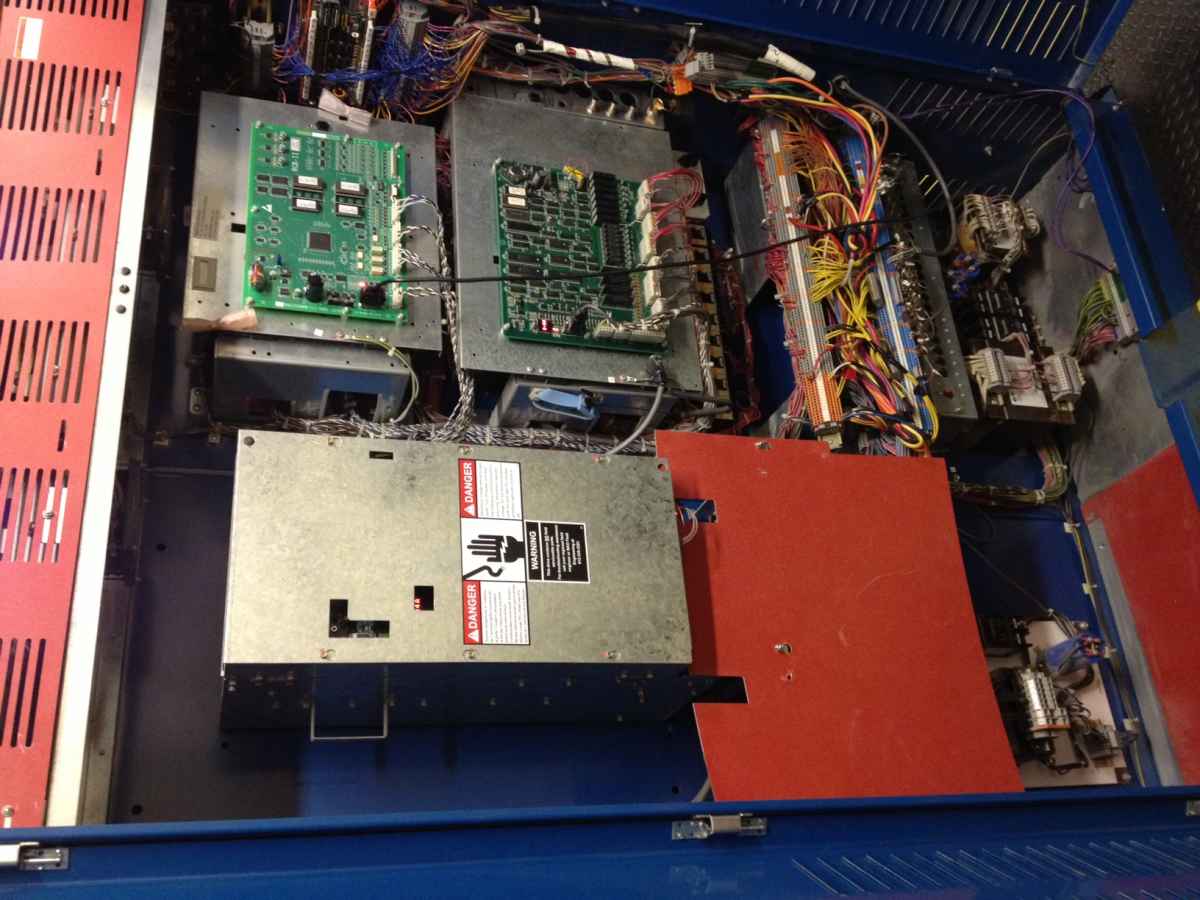

I have this 311 controller with no door disconnect switch. Usually, Otis installs a Hall Call Cut-out switch and Door Disconnect switch on 311 / 411 Controllers. Was this normal for this controller version or is there some other way to disconnect the doors in the controller?

You have to change a I/O. With a service tool or laptop enter M132. Then enter 2490 (DDO) change 010 to 000. 2489 is CHC, or independent service. Change 000 to 010.

Thanks for the tip. I'll have to try that next time I go back to the job.

I always used the I/O 323 changing it from 010 to 000 to disable hallcalls for that unit.

323 is car link 2489 is the hall link both do same thing
